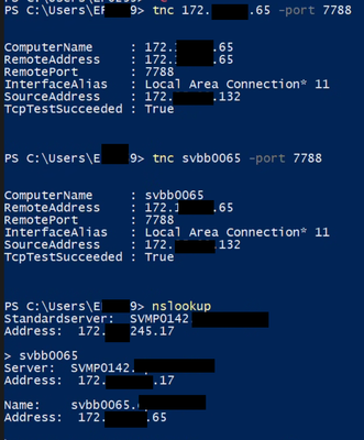

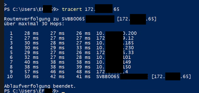

I am the responsible network admin from  MR_10682149 and i testet what you describe.
 The tracert is working
In addition to that, also tnc and nslookup ist working.
The License Server is on our company site and reachable trough Pulse.
I couldn't figure out why Creo isn't starting.
Between Pulse and the License Server is only Layer 2 Filtering, and no other firewall rules, which would block the traffic.
Is there any log folder on the client where i can figure out why it runs into timeout and crash?
Also in the license file is only the license server entry
kind regards. and thanks

Thanks for the images and info.
I would start with checking the FlexLM license service logs on the license server. Do the license server logs for the PTC license service show the PC is requesting a license? If not, then the FlexLM service isn't getting a request at all, and you should check the 2 communications ports. The LMGRD.EXE port is 7788. If you're not specifying a vendor daemon port number in the license file as described earlier, you can look at the log file to determine which random port was selected by the vendor daemon. The communications need to work with both port numbers. If you have access to Wireshark, you can load it on both machines and monitor both ports.   The images show you running the commands from the PC to the server. Did you run the same commands on the license server to the PC?
The response times from the tracert look good. I wouldn't suspect a FlexLM timeout issue based on those numbers.
Does your company enable the Windows 10/11 firewall on the laptops when they connect via VPN or more generically, when the laptop isn't hardwired to your domain or on the company WiFi (typical in my company)?  Just another consideration.
What is the behavior of Creo Parametric at startup? Is it stating that a license is not available and shutting down, or is the software crashing on startup?  They are 2 very different issues.
Dan N.
