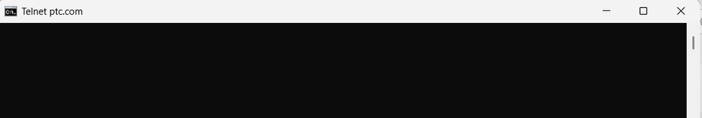

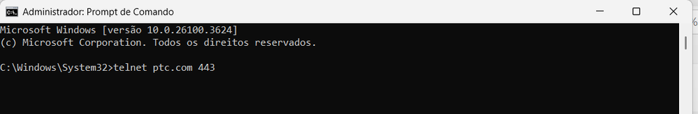

We are trying to use Creo performance advisor , but information from the machine is not arriving on the panel , we have already unblocked the Firewall and antivirus , we did a telnet test as shown in the following print , and I also put the site https://apps.ptc.com in the browser and the error Http/1.1 Service Unavailable appeared , would I need to do anything else for this CREO to appear on the panel ? I'm running Version 8.4Telnet.pngTelnet01.png

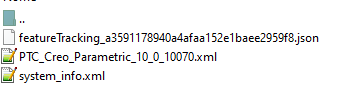

Your zip file contains only 1 file which is the one with information about your system (HW and SW configurations).

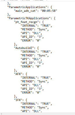

There are not the other two files, the json that contains information about the features used (see first image)

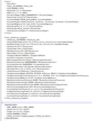

Nor the XML file with the session data (see second image where I replaced the sensitive data with XXXXXs)
