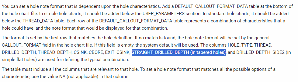

I am using Creo Parametric Release 10.0 and Datecode10.0.1.0
Tapered threads do not show up in the dialog box once I add a DEFAULT_CALLOUT_FORMAT_DATA to the hol.-file.
The hol.-file has previously worked in Creo 8
you have to add STRAIGHT_DRILLED_DEPTH token into DEFAULT_CALLOUT_FORMAT_DATA section.
https://support.ptc.com/help/creo/creo_pma/r11.0/usascii/index.html#page/part_modeling/part_modeling/Thread_Notes.html

I have attached the hol.-file.
Does anybody know why the thread does not show up in the dialog box once I add a DEFAULT_CALLOUT_FORMAT_DATA to the hol.-file?
Everything has been done according to:
Formatting Thread Notes (ptc.com)
Thanks in advance.
Martin Hanák
Hi @TA_10763298
As @MartinHanak mentioned, add STRAIGHT_DRILLED_DEPTH in Callout format. Tested the same and it is working well with your file.
Same file was working well without STRAIGHT_DRILLED_DEPTH in previous versions however starting from Creo 11.0 it failed to load due to strict validation of file.

Yes, it works well with my file now.
Thank you for the help!
