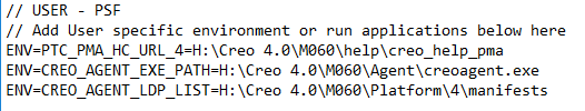

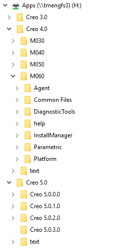

I install it locally on my workstation and then copy it to the server.  I used to install with the default path (C:\Program Files\PTC\...) but then I was forever using Notepad++ to change paths in all the different .bat files to match the mapped drive letter and the server's folder structure.  Now I just disconnect my mapped drive and recreate a new temporary mapped drive to a folder on my local computer that has the same folder structure and drive letter as the server.   I install the program, configure everything, and then copy this folder to the server.  I then uninstall everything from my local computer, remove the locally mapped drive, and remap the drive to the server.
One of the benefits of setting these path variables is that I can adjust their positions in the folder structure to my liking.  I keep a separate copy of the Creo agent for each build code of Creo.
