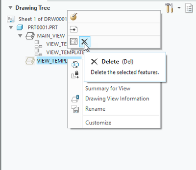

Are you able to look at the drawing tree? You can select views to erase and resume from there by picking the view. In my test, I can see the view if it's erased or resumed. I can delete it in either state as well. When a view is erased it appears as a hidden item in the drawing tree. I opened your example but didn't see any erased views on either sheet. Maybe I'm missing something?
The erased views are not in the Drawing Tree.
The detail D cannon be renamed either A, B, or C. This happened because there are erased and not deleted views with those names.
Their contour can be seen if I try to delete the sheet. But I cannot select them otherwise.
