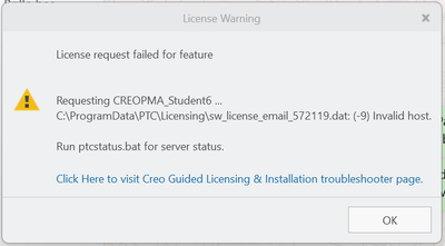

I have installed my CREO 8.0.4.0 student edition two months ago and now i get the Error message that the "license request failed for feature."
Error code -9.
Please find picture underneath.

Since you have Creo installed, navigate to the Parametric\bin folder in your Creo installation (you can probably find it by right clicking on any Creo shortcut, Open File Location), open a command prompt there (you can do this by clicking in the address bar, type CMD, hit enter), then enter the command:
ptchostid.bat
This will tell you what Creo sees as your host ID. If it does not match 98-AF-65-73-18-FB, you'll need to request a new license file with the correct host ID.

HOST-ID included in license file does not correspond with physical address of any network card installed in your computer.

please do following:
  • upload MartinHanak_0-1733219541355.png file
  • open Command prompt window
  • run ipconfig /all > ip.txt command
  • upload ip.txt file
I will investigate both information sources and let you know what to do.

Please find both files below. I renamed the file sw_license_email_572119 to a text file, because it did not allow me to upload a .dat file.
did you really upload MartinHanak_0-1733229656014.png file? I can see sw_license_email_572119.txt file
Inside sw_license_email_572119.txt file I can see:
  • INCREMENT CREOPMA_Student6 ptc_d 40.0
    • 40.0 means Creo 9.0
  • HOSTID=PTC_HOSTID=98-AF-65-73-18-FB
    • this PTC_HOSTID is available in ip.txt
Wireless LAN adapter Wi-Fi:
Description . . . . . . . . . . . : Intel(R) Wi-Fi 6 AX201 160MHz
Physical Address. . . . . . . . . : 98-AF-65-73-18-FB
I can't see any problem.
Note: Maybe OpenVPN adapters are causing your problem.

Hi Mr Hanak
My Creo works again the way its supposed to. The thing is i use Creo at my university and need to activate the universities vpn to access their server through Creo. (I also use a program from my university, which opens Creo with their server - i never open Creo by itself). I believe there was probably a error due to the open-vpn and my local licsenz and the host ID. By using the prompt and command line you suggested i saw that the two Host ID line match. I probably did not have my vpn activated before opening creo.
Many Thanks
