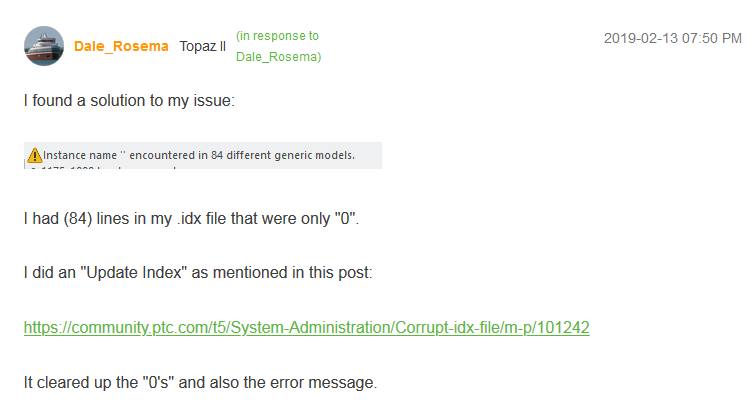

I am getting the following error:
Typically when I get this it has a valid instance name and I find duplicates and correct them.
Any suggestions on this? (Only two systems, so no Windchill here).
Dale

Usually the error is: Instance name abcd_1234  encountered in ### different generic models.
I cannot figure out the "
look at https://community.ptc.com/t5/Part-Modeling/Locating-different-generic-models-that-contain-identical/td-p/566520?art_lang=en&posno=1&q=encountered%20different%20generic%20models&source=search
It contains your reply ...

Update index did the trick again.
Does anyone know why I might be getting this in the first place and how I can avoid it in the future (besides doing an index update).
