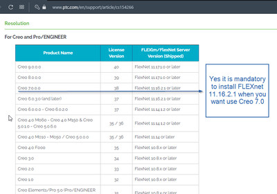

So I went to install the license server for Creo 7 on my license server and it does not want to use the NIC mac address that the current license server is using on the same machine.  Has anyone else seen this and know why it is doing this or how to get around it?  When I do ipconfig /all, it shows 4 NICs and the one it is picking is the last one in the list.
**Update*** I have two NICs that are teamed.  The current license uses the teamed NIC MAC.  I have disabled the 4th NIC which is something Dell has for the SAN but we have found unnecessary.  But now the new license server wants one of the NICs and not the teamed NIC.  Any ideas?

1.]
Creo 4.0 installation package includes FLEXnet 11.14 -OR- FLEXnet 11.14.1.2
2.]
Creo 7.0 installation package includes FLEXnet 11.16.2.1
3.]
It is not mandatory to install FLEXnet 11.16.2.1 when you want use Creo 7.0. Just replace the contents of the license file.
4.]
Creo 7.0 will work with FLEXnet 11.14.1.2 (I hope that with FLEXnet 11.14, too).
Martin Hanák

@Sanath - Yes the Creo Flexnet server is currently on this machine.  I am able to run Creo 4 and Creo 6 on this machine.  I am trying to update so that I can run Creo 7.  In the current configuration I have 2 NICs that are teamed.  The current Flexnet is pointing to the teamed MAC address.  I do have a call open and tech support is saying that it doesn't use the teamed MAC.  I don't know if this has changed in what I am trying to load since what I do have is pointing to the teamed address.  Thank you for the registry info.  I will have to go in and set one to be the primary so that I can get a license file for that MAC.  I hope that answers your questions.

@MartinHanak
Thank you for your response.  I had misread "recommends" for "required" when I downloaded Creo 7 and what the license server needed to be.  Back in December when I changed servers I installed Flex from Creo 4 and thought that the version I installed was 11.14.1.2 but it turns out I had the Creo 4 with 11.16.2.1.  It makes no sense on why Creo 4 was able to pick up the teamed NIC and Creo 7 cannot.  When talking this over with IT, they can't understand why companies still use the mac address for licensing.  Creo isn't the only things we have in house that use it.  If there isn't a enhancement request out there that I can vote on to change it, I will be creating one in the near future.

The later versions of the license server will work with all earlier versions of Creo.  For example, 11.17.1.0 will work for Creo 9.0, 8.0, 7.0, 6.0, .... Wildfire 2.0, etc.  They are backward compatible but not necessarily forward compatible.  Newer versions of Creo take advantage of newer features in the license file that older versions of the license server won't understand.
