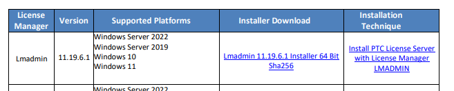

I did a quick check and for Creo 10.0.6 the download area tells you:
Creo 10.0.6.0 is packaged with the PTC License Server powered by FlexNet Publisher 11.19.6.1. For VERY IMPORTANT information, refer to CS413906
So if you take care of things to comply with this requirement, you should be okay.

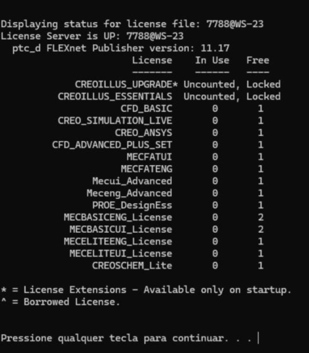

If you run ptcstatus, what do you see?
It's a batch file located in something like "C:\Program Files\Creo 11.0.1\Parametric\bin". It should tell you the version of FLEXnet Publisher your computer is seeing (mine is 11.17).

Here's how it looks

So, the third line says that you're running version 11.17, while the error message says the minimum it requires is 11.19.
FlexNET needs to be updated to 11.19 (and restarted).

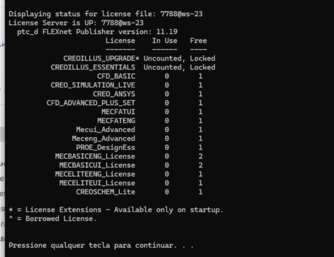

I've just done it, now CREO Anysys Simulation isn't working.
