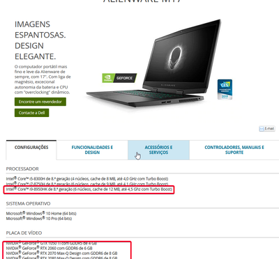

Regarding Radeon graphics card, do you have experience with them? I do Believe that clock speeds are really important. I remember a couple years ago, seeing an I5 processor, beeing much faster than an i7 processor. The clock speed of i5 was higher.
I was looking for Dell's webpage, and I found this laptops, dedicated for gaming:
it has the processor Intel® Core™ i9-8950HK. As far as I know the processor with termination letter with K, are the ones most suitable to overcloking. But I have affraid of not using quadro graphics. The last time that I have used non quadro graphics it was about 10 years ago!!!!
