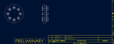

I am trying to get both the quantity and the description to populate my table reports when using ANSI-English hardware. My QTY column is set to rpt.qty. I have a column labeled asm.mbr.description.

My issues is that the hardware used from IFX does not appear in my BOM
See image below:

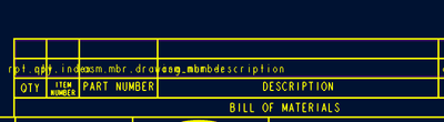

I am pretty sure that the text file for the hardware needs to reflect what my repeat regions are set to look for from the hardware part file.
See image below:
I do not want to change any of my parameters in my repeat regions on the drawings

Creo does not display IFX hardware in your repeat region because IFX model does not contain parameters applied in columns 2-4.
If you add asm.mbr.name into any column then Creo displays IFX hardware.

You do not modify the .dat files, but the Creo template model and add the parameters you need in there. You may have to add the parameters as relations to generate the proper information needed to populate the parameter for the BOM table as you need.
This will require the full license to the IFX system, not the free lite version included with Creo.
