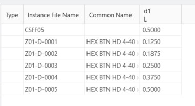

Hi, So I went through and changed some of the screw/bolt names within the family table, though I made sure not to change the name of the generics or the heads of each sub family table. I've done this in the past and it worked fine. It also still recognizes all the new names and pulls in the correct bolts with the correct names upon startup. I am also able to open up the top level generic part and all lower level generic parts, as well as the renamed parts just fine.
My issue is now that when I go to use the intelligent fastener tool it tells me that a model cannot be found. The way it names the model is very odd too, it seems the model has the same name as a file path, and the file path it gives never held the part in it anyway (the csff.prt file is not located in the "ifx_fastener_data" folder, it is located in the prolibrary folder, and I made sure of that on a differerent machine that had not yet updated their ifx prolibrary). I'm not sure how to move forward or find a weirdly named model that doesn't seem to exist anywhere. any help would be much appreciated.

Here you can see that I did not rename the lower level generic files, but am still able to open all of them.

Thank you Oliver! It was the fact that the names inside of the .dat file weren't changed to match the family table. After correcting that it works just fine!
