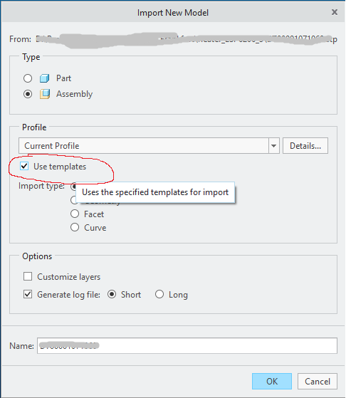

Hi, I would like to ask for help with default setting of importing step files. Default setting is NOT use tempate and I have to switch it everytime. Problem is people often forget to do it and I have to fix it quite often.

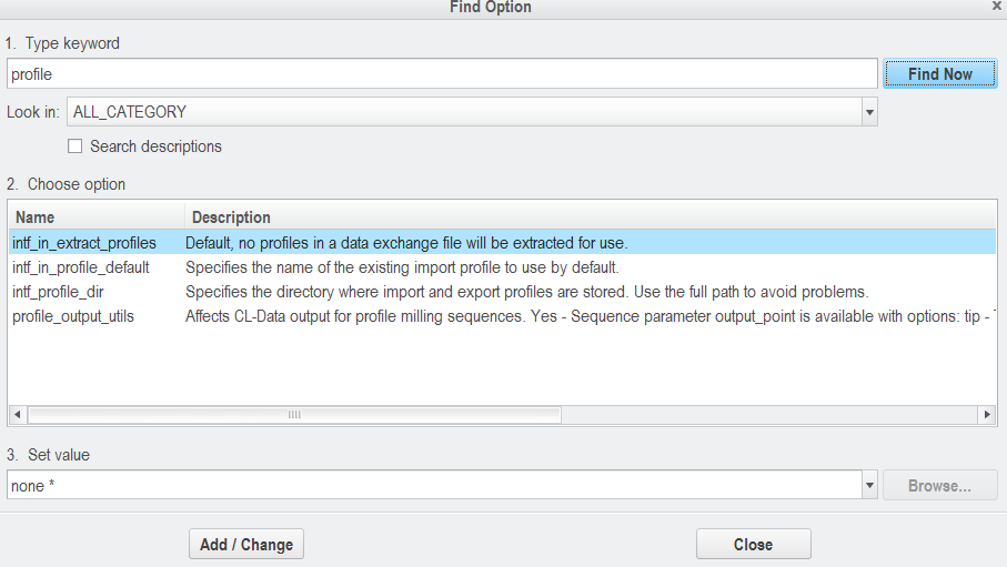

Set up and save a profile with the Import profile editor (Tools->Utilities, or search in the ribbon)
Then point to this profile file with the config.pro option intf_in_profile_default.

It works perfect, thank you.
