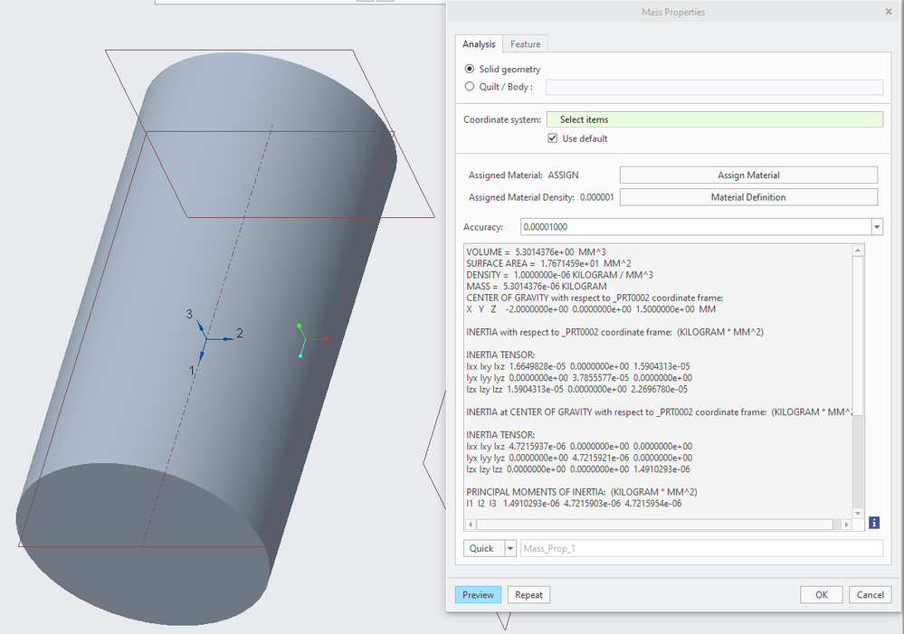

I am using Creo Parametric Release 7.0 and Datecode7.0.9.0
When I use Analysis / Mass properties / preview
The coordinate system displayed at center of gravity with respect to principal moment of inertia axis (1, 2, 3) seems not correct. For example, if I extrude a cylinder whose axis is not colinear to origin cordinate frame, the principal moment of inertia displayed is not colinear to the cylinder (when it should be)

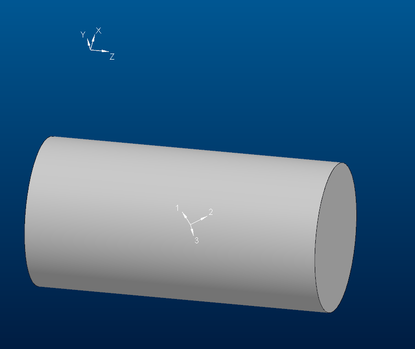

in Creo 7.0.5.0 I can see this "picture".
1.] maybe your Creo 7.0.2.0 contains a bug (try installing 7.0.5.0 to verify it)
2.] maybe your config.pro contains some specific option causing the problem (please upload config.pro)

1-2-3 temp coordinate system at center of gravity is exactly where I'd expect it.
Thank's for your answer,
I made the same cylinder as you did. I have exactly the same mass analysis (different units 😉).
But the axis displayed seems to correspond to nothing, see attached picture. In my opinion, the axis I1 should be colinear to the axis of the cylinder (parallele to z axis).
What do I miss ?!

please pack your part into zip file and upload zip file.

Hi @BB_10451093,
I tested the part in Creo 7.0.2.0 and 7.0.9.0, already tested by Martin in Creo 7.0.5.0, seems it was a bug in Creo 7.0.2.0 as it is reproducible for me in Creo 7.0.2.0 but not in other datecodes.
Check the image from two of the datecodes
