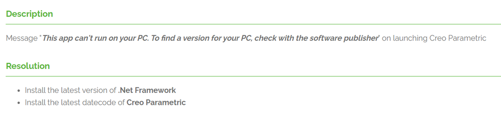

Try the solution from this article - "This app can't run on your PC - to find a version for your PC, check with the software publisher": https://www.ptc.com/en/support/article/CS332423
