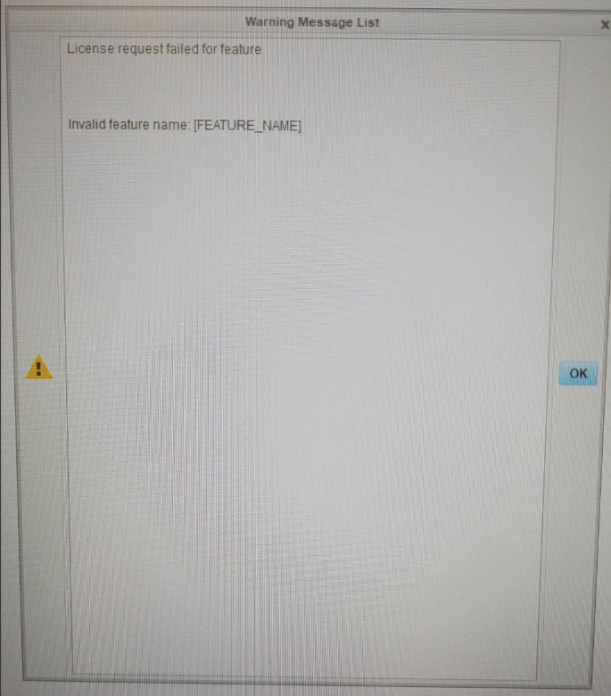

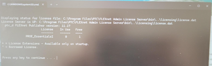

I am in the same situation. The installation works fine for PTC Creo Parametrics 3.0 M190, but flexnet fails. I tried PTC License Server 11.19.1.0 and PTC License Server 11.17.1.0.
Reference topic: https://community.ptc.com/t5/System-Administration/Installing-Creo3-under-Windows-11/m-p/976775#M31407
 Snímek obrazovky 2025-04-23 083157.pngSnímek obrazovky 2025-04-23 083115.png
Any advise or solution?

you have to put the right license information into parametric.psf file located in Creo installation.

I suppose, that I need change this 2 lines, but I need more sofisticated manual.
Thank you.

just remove square brackets to get:
ENV=PTC_D_LICENSE_FILE-=7788@Konstrukce03
ENV=CREOPMA_FEATURE_NAME=PROE_EssentialsI ()

It not help.

solution = correction of parametric.psf contents. See below:
Martin Hanák
JerseyC
6-Contributor
(To:MartinHanak)
ENV=PTC_D_LICENSE_FILE-=7788@name_of_your_computer
PROE_EssentialsI () - Means name of your package
Version of Flexnet 11.17.1.0 has to be installed separately
