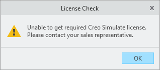

The problem is, although the other group is able to obtain licenses from our pool of available licenses, they are unable to run the Simulate application. It does not work for them insisting that they do not have a license, etc.
In the past, when I had troubles with Creo Simulate licenses, I had to manually edit the "feature.dat" to "tell" Creo what license to look for when attempting to run the program. I provided instructions to the folks at the other site as to how to do this, but it doesn't seem to have worked.
Does anyone know of any restriction that may be preventing us from sharing this type of license? Are there configurations that need to be addressed to make this work?

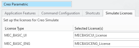

Take a look at 'feature.dat' in "\Common Files\applications\simulate\text\licensing\mech\".  These lines control Creo's ability to dynamically pull a Simulate license while Creo is running.  Need to have something other than '<No license features>' listed here.
MEC_BASIC_UI "MECBASICUI_License"
MEC_BASIC_ENG "MECBASICENG_License"
STRUCT_UI "<No license features>"
STRUCT_ENGINE "<No license features>"
STRUCT_THERMAL_UI "<No license features>"
STRUCT_THERMAL_ENGINE "<No license features>"
MEC_ELITE_UI "MECELITEUI_License"
MEC_ELITE_ENG "MECELITEENG_License"

Modify "feature.dat" to include the licenses for Simulate, with the two lines
Run a reconfigure, so the data now provided in the feature.dat can be applied.

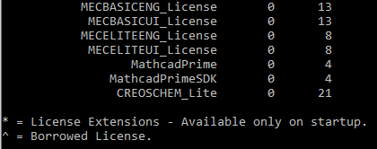

When they run "ptcstatus" from a system window inside Creo, do they see your license server and the simulate licenses listed?
The VAR is correct on global licenses.  If you didn't pay (double) for global licenses, then they can only be used in the region they were purchased in.  Creo global restricted licenses are obvious because they include 'GR' at the end.
To be clear, they will function fine globally, and there shouldn't be any issue testing, but for audit purposes you definitely don't want to continue running regional licenses globally.
