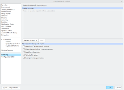

File - Options - Licensing - Info
Info tab on my system is dead. Can't select it for some reason.

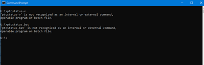

When I run in DOS mode, it says not recognized:
ptcstatus does not run correctly when I've just installed Creo. The installation process doesn't seem to, for me, set the path specifications correctly, so the command window is unable to find the program. I always have to change my path to include the Creo installation "bin" directory. For my current installation, this is:
C:\Program Files\PTC\Creo 9.0.1.0\Parametric\bin
This is where ptcstatus.bat resides. If you have administrative priviliges on your computer, or can temporarily obtain them, you can set the path environment variable to include the above path specification, then ptcstatus will work for you.

That option is grayed out on my system, too. I am the admin!

I am on a client computer and when I try to run the command, following error appears:
