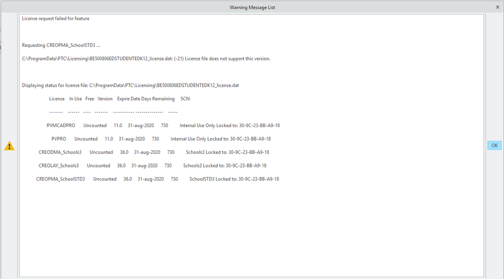

Hi, My name is Marc. I am a college student trying to down load and install Creo 6.0 to do homework. During the install i got the attached file in an email. with no instructions - just a blank email with that file attached.
Anyway -
After downloading Creo 6.0 and running the file "setup-school.exe" i installed Creo 6.0
Then -
I started Creo Parametric 6.0.1.0 and got the following pop up .... sent in a ticket but it said 2 to 3 days before i can expect a reply, well that blows! esp with a long weekend - so can anyone help????
3 REPLIES 3
The email attached file was/is
License Pack.dat file but it doesnt say what i am to do with it - i did try adding it to the PTC lic folder - but the same error poped up
@Mrickeard
Remove the dat file.. in error and place the new one from email at that location. Once done, open parametric.psf from installtion location of Creo 6.0\parametric\bin in notepad and update the path for ENV=PTC_D_LICENSE_FILE.
