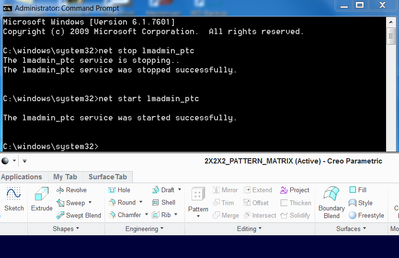

Now this very same problem still exists on my new Lenovo P70.
I still have the latest license server.  Still running Windows 7.
Right now, my only work-around is to keep an open session of Creo when I close the cover.
You'd think this is something someone in the "PTC FIT AND FINISH" department would have looked into by now.
Can someone walk me through the Task Manager to know how to reset the license server?
I have a stand-alone license (locked?).
to manage lmadmin_ptc service status:
  • open Command Prompt as Administrator
  • to stop the service, use command ... net stop lmadmin_ptc
  • to start the service, use command ... net start lmadmin_ptc
MH
Martin Hanák
This looks promising, Martin.
I will update this post if this works next time.
Thanks again, Martin.  That did the trick.  A few seconds for the stop process and almost immediate on the start.

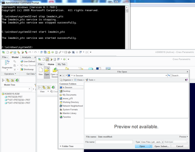

I noticed another very troubling thing after sleep mode...
I can open more than one unassociated window in Creo at some point.
Literally starting 2 instances of Creo!
I was able to do this before implementing your solution.
When I look for "in session" files, they are completely independent.
Now mind you, I only loaded Creo 2.0 M040 on this computer.
I have not used any later installers.
This is two open session on a single locked license...
I use to get a license error when I did this on my Dell M6600 with the older license server.
Notice the 1st open session with a loaded file and the second session that has no files in-session!
Anyone else able to do this?  Is this the "new normal" (noting that I had a very old license server before...)?
I doubt this is a license problem as this is the same machine.
Just never could do this before... and I wonder if it could generate file problems.
Hi Tom,
please read https://support.ptc.com/appserver/cs/view/solution.jsp?n=CS234779 document. It explains your last "problem".
Simply said ... Creo license codes generated after 01-September-2016 contain DUP_GROUP=UHD keyword. Because of this, you can launch any number of Creo sessions on your notebook even though you own 1 floating license.
