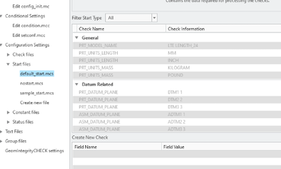

I am using Creo Parametric Release 9.0 and Datecode9.0.0.0
Totally new to Creo. Trying to open up the ability to edit the configuration settings in ModelCHECK (Check Files, Start Files, etc.) so that we can create custom defaults- currently these options are greyed out. Can these settings be unlocked or what is the procedure to accomplish this? Thanks!

The first thing I do is copy the ModelCheck (mdlchk) folder to a common network location.
The files under the text folder can be edited with any editor.

So I have created a copy of the modchk folder and changed the path. Does this look correct to you? Should the config files now be editable within Creo, as shown? or do we need to edit them outside of Creo?

Youi should be able to edit them from Creo, if you are in the admin 'group' of ModelCheck. You do NOT want all users to be able to edit the ModelCheck files. Personally, I edit the files with Notepad outside of Creo.
Thanks again for the reply Ben. You've been a big help already.
I have been working with the admin settings. My understanding is that you modify the MC_AUTHORIZATION_FILE line in the config_init.mc file as shown -
Then you create the external_access.txt file at the following location (C:\Program Files\PTC\Creo 9.0.0.0\Common Files\modchk\text\usascii\config\text) using the following format -
# ModelCHECK authorization file
#User List
LIST_ADMINISTRATOR administrator
LIST_ADMINISTRATOR <insert additional admin>
#User List
LIST_USER
Is that correct?
BenLoosli
(To:SS_10441348)
That looks right.
Does it work for you?
Currently not working still from within Creo but may be a path issue. Is this the correct path or what is the root location it's looking for? -
"\\Server\*\Creo\modchk\text\usascii"
Actually looks like it's working now. Thank you for your help!
