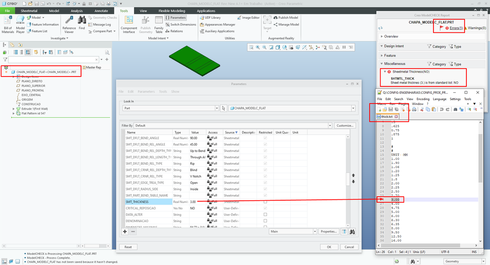

Hello everyone,
I am experiencing an issue with a specific ModelCHECK verification in sheet metal parts.
I have configured the thickness validation in ModelCHECK to report an error if it detects a value in the SMT_THICKNESS parameter that differs from those defined in the thick.txt file.

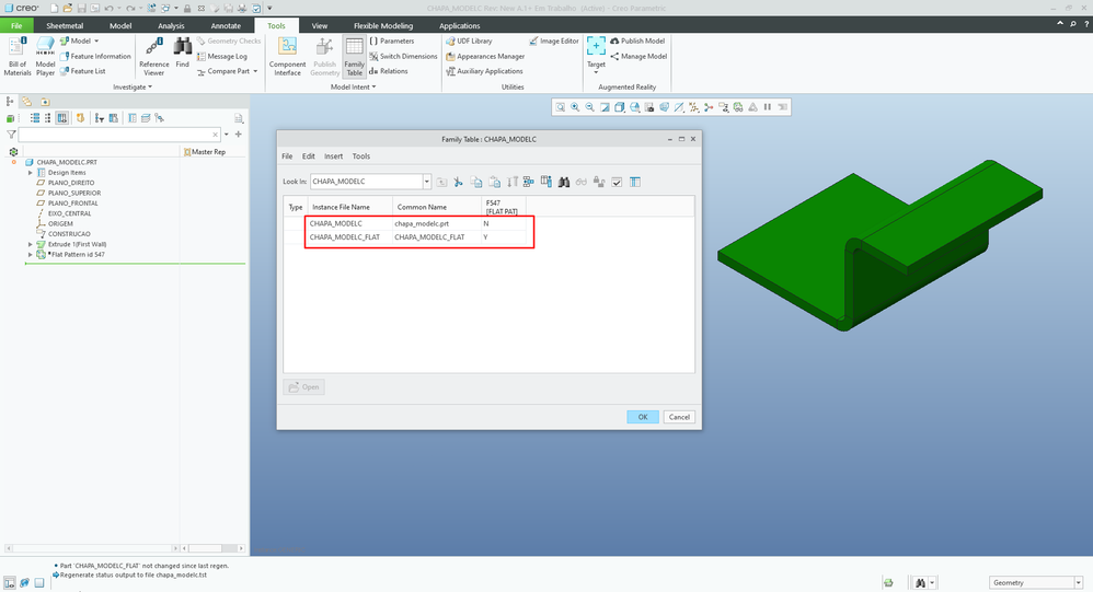

This issue only occurs in files containing the Flat Pattern instance. Since we have many legacy files in this condition, the problem has become quite frequent.
As a temporary workaround, I have been making minor changes to the generic file and updating the Flat Pattern by verifying the family table. However, there are cases where I need to edit the instance itself, and in such cases, ModelCHECK does not perform the validation as expected.
I have attached an image that illustrates this issue.
Could anyone assist me or suggest a possible solution?
I'm using CREO 9.0.9.0 release.
Thank you.
