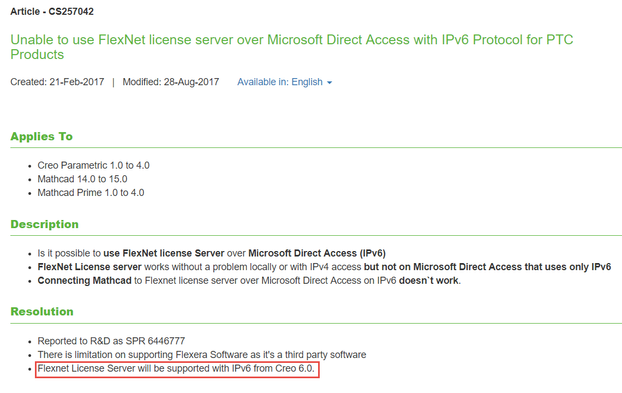

Domen
(To:ehill)
Good news guys, this will be implemented soon... in Creo 6.0. Smiley Frustrated
  • Flexnet License Server will be supported with IPv6 from Creo 6.0.
