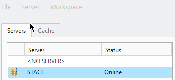

That is the error!
You have your registered name as STACE.
The config.pro is looking for Stace.
The registered server name is case sensitive and MUST match exactly for all users to what is specified in the config.pro file.

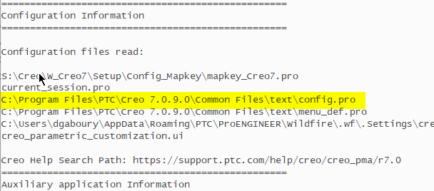

BenLoosli
(To:DG_11774740)
Open your Creo session.
Click on File, then Help. Select System Information, then System Information.
In that pop-up window, scroll down to the section:
Configuration Information
Configuration files read:
That will list your configuration files that are loaded at start up.
Check the config.pro file listed to be sure it has the right syntax for your start_model_dir and pro_format_dir.
Hi Ben,
Here is the listing of config file read
The config parameter are in the file highlighted.
This config.pro is the same for all users, but for some reason start_model_dir and pro_format_dir doesn’t work

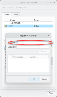

By using a Windchill location, everyone MUST register the WIndchill server with the same name, in your case 'Stace'. If anyone registers the server with a different name, like pdmlink or windchill, the system will not find those folders since the registered name does not match what the config.pro setting are looking for.
Here is the name for the Windchill Server : STACE
BenLoosli
(To:DG_11774740)
That is the error!
Thanks, it is resolved!

Just to add to what Ben said...the server name must match EXACTLY...Stace is not the same as stace or STACE....It's case sensitive.  This is the most common cause of the issue.
