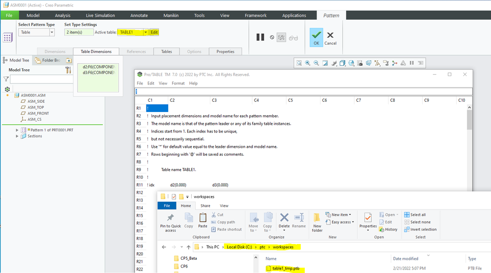

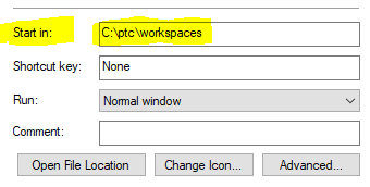

Users must have write permissions to Creo's start-in (working) directory.  This location should not be on the network.  It can be set right in the startup shortcut.
I have no trouble accessing the table editor with Creo running from the network because the temp table is created in my local working directory:
Perfect @TomU !  That resolved the Pro/TABLE issue.  I'll continue to investigate running local vs network.
