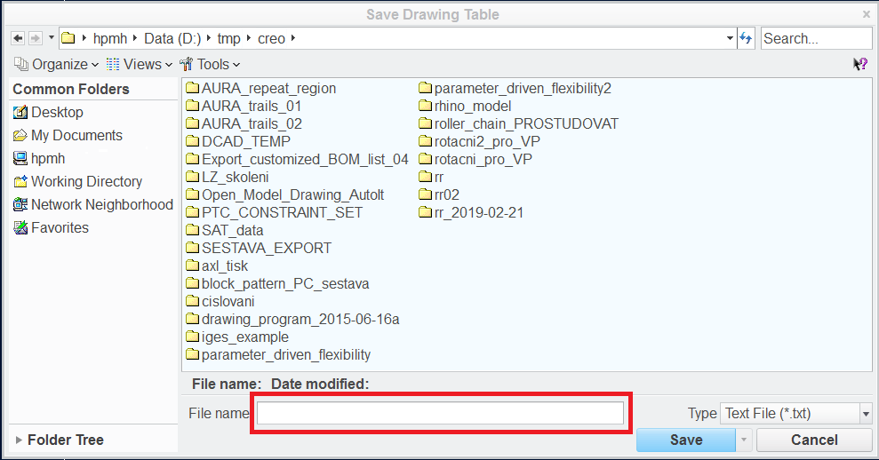

1.] AutoIT script can extract drawing name from window title and put it into Windows clipboard
2.] It is possible to run AutoIT script via Creo mapkey
3.] When table is saved following dialog is displayed. User can activate File Name field and press CTRL+C to enter drawing name extracted by AutoIT script.
