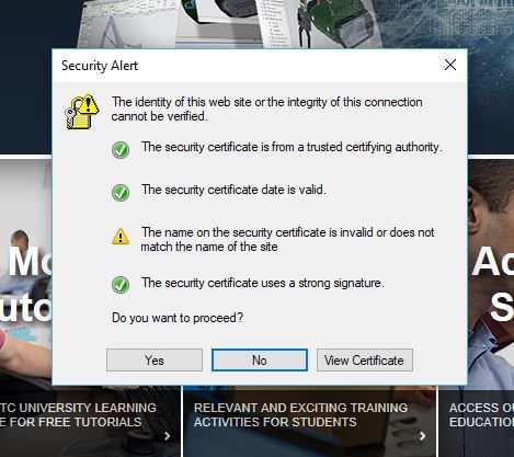

Whenever I start Creo 4.0, this error message pops up. I reinstalled Creo several times, and it doesn't go away. I have the student version.

This looks like a message produced by the internal browser about a default website. It isn't a problem with Creo, so reinstalling won't work to fix it.

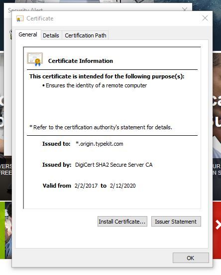

What message pops up when you select "View Certificate"?
blubot4
3-Newcomer
(To:dschenken)
Sorry for the late reply.
Here it is.

As @dschenken mentioned this is related to browser. Found a post from Microsoft Community, this may help. Better involve IT to correct this
https://answers.microsoft.com/en-us/ie/forum/ie11-windows_7/security-alert-the-identity-of-this-web-site-or/73ed5064-7977-480e-951d-426039ef8265?auth=1
I do your step,but it's shouldn't work sir. any other method.
