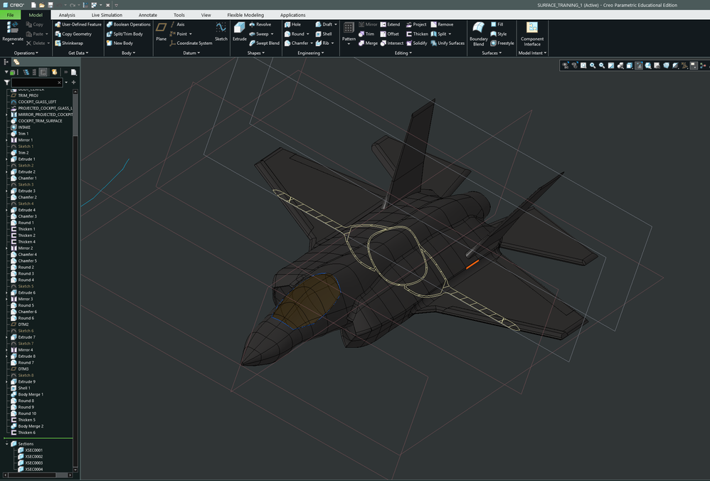

About assembly, I'm sorry but I don't do those much. I'm just a university student and things aren't very complex and hardly above 5-10 items per piece. Graphics are good, I can show you a fun project I did with Freestyle on my Mac mini M4, I didn't feel lag during the process!
Easily running shaded or reflection mode, can even try rendering maybe if you have PRO cpu. Although obviously no support for ANSYS or Simulation so far because missing drivers.
