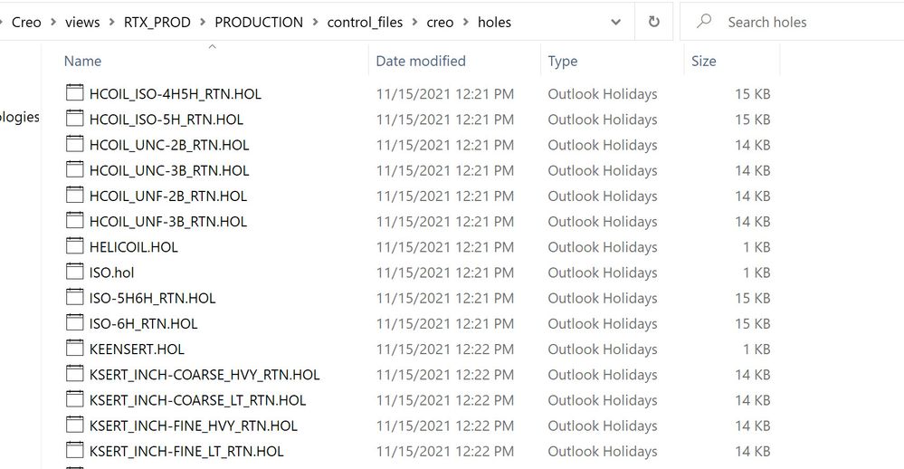

What do you mean by 'unable to find'? There are only a few thread sizes (*.hol files) shipped with Creo. If one of the files doesn't have your threads, you need to create your own thread file.

llie
(To:KS_9802404)
KS,
You need to add this line in your config.pro that gets pushed out to the users and point to the location to the file that you are pushing out to your users.
hole_parameter_file_path $VIEW_SOURCE\control_files\$PROE_REL\holeshole_parameter_file_path $VIEW_SOURCE\control_files\$PROE_REL\holes.
Look at the path at the to of the image.
