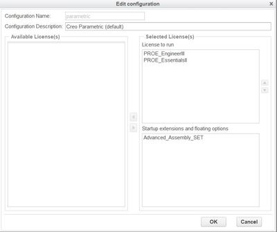

I am standing up a new license server and after beating it in to submission so that it runs stably I am now encountering something that I do not understand.
I am able to connect a session to the server and get a Creo Essentials II license but when I try to request an Engineer III license I get an "unable to connect to the license server" error. It is not a no licenses available error but a can't connect error. There are licenses available and if I drop back to just the II license it grabs one just fine.

I can ask it to pull only a Creo Essentials license and it has no issues. I ask for the Engineer III and it can't.

It is a single license file on the license server. The file shows both as available. I am launching from the Creo Parametric desktop short cut that is created when you install Creo. If I configure Creo Parametric to ask for a Creo Essentials license it works just fine. Changing nothing other than re-configuring to request an Engineer III license I get a "server is not available" error on start up.

Try launching the parametric.exe file from the install location.
If both licenses are configured, it should give you a pop-up asking which license you want to use.
It does not ask me which license I want to use it just grabs the Essential II and will not pull AAX with it.
To close the loop on this, it is an issue with the Creo and the error message that it throws. I was not clearing the AAX request and when Creo 4.0 M110 tried to bull both an Engineer III license and an AAX license it became confused. Instead of presenting a "license unavailable" message it instead throws a "Server unavailable" error and shuts down.
Requesting just an Engineer III license and removing the AAX request and it is happy.
