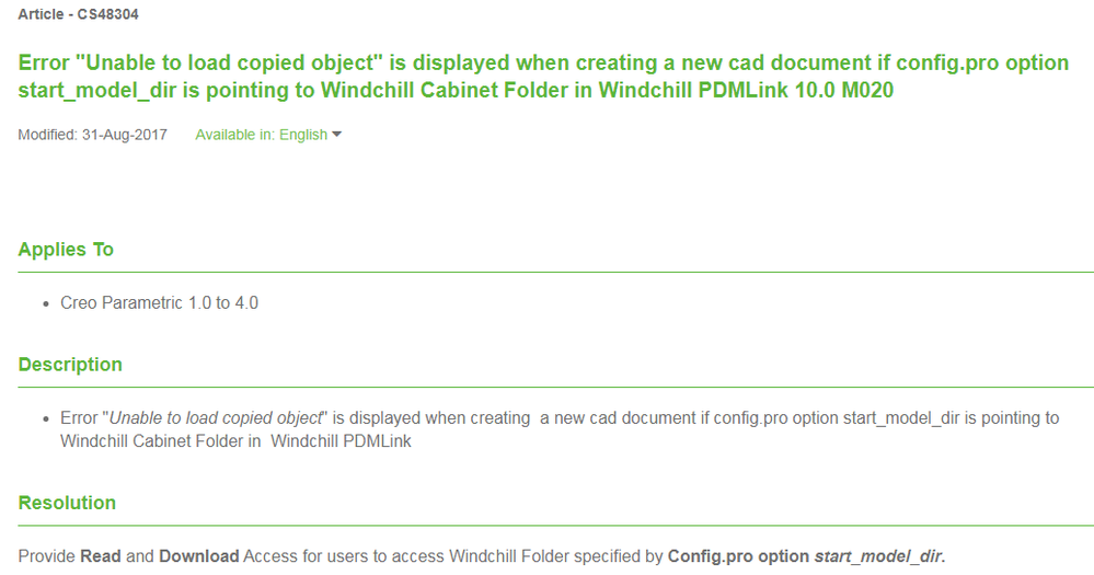

Unable to load copied object prt001.
NS_9626350
2-Explorer
How to resolve this error. It happens every time whenever I try to create a new file.
