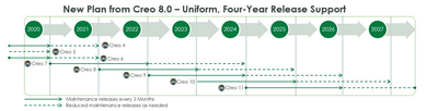

Correction as noted:
@Dale_Rosema wrote:
The logic behind the 4.0 -> 7.0 -> 10.0 jumps is that these are the major releases that are fully supported from one to the other.
The in between releases are only supported (or limited support) until the next release.
That logic has changed with Creo Parametric 8.0. All releases are treated the same with Creo Parametric 8.0+
"New release support schedule starting with Creo 8.0"
https://www.ptc.com/en/support/article/CS339031
