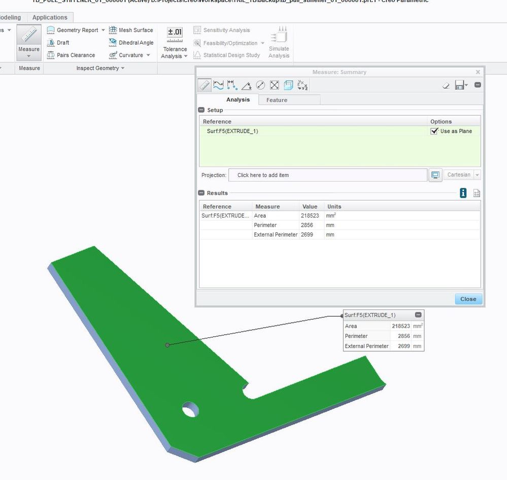

jhaston-3
(To:pmydur)
You can use the measure tool. Measure the surface area and then look at the summary of results ...

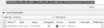

Dan-Baker
6-Contributor
(To:pmydur)
This is what we use to calculate the perimeter (including cut extrudes) of formed parts. Running Creo 7.0.7.0
1. Add relation to Sheetmetal Start Models.
PERIMETER=(PRO_MP_AREA - (2*(PRO_MP_VOLUME/SMT_THICKNESS)))/SMT_THICKNESS
2. Mapkey that saves mass properties and regenerates the model to update the Perimeter Value..
mapkey ww @MAPKEY_LABELMass Prop Calc / Regen;\
mapkey(continued) ~ Close `main_dlg_cur` `appl_casc`;~ Command `ProCmdMmModelProperties` ;\
mapkey(continued) ~ Activate `mdlprops_dlg` `MASS_PROPS_lay_Controls.push_Change.lay_instance`;\
mapkey(continued) ~ Activate `mass_prop_dlg` `CalculateMPPush`;\
mapkey(continued) ~ Activate `mass_prop_dlg` `OkPush`;\
mapkey(continued) ~ Activate `mdlprops_dlg` `DlgClose_push`;\
mapkey(continued) ~ Command `ProCmdEnableAutoRegen` 1;~ Command `ProCmdEnableAutoRegen` 0;\
mapkey(continued) ~ Command `ProCmdRegenPart`;
