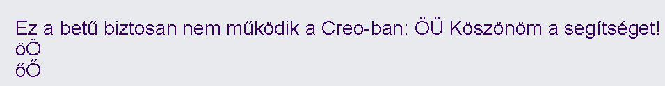

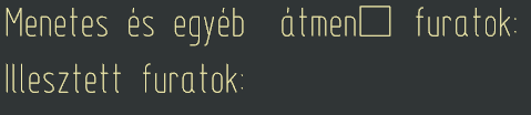

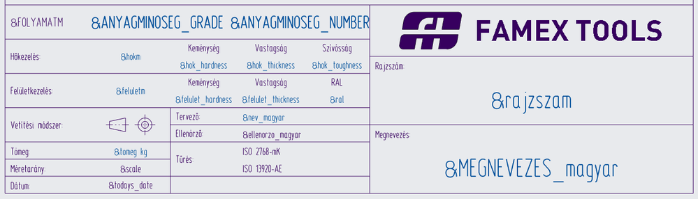

The font is loaded, but where the hungarian (ő for example) char should be shown, there is only squares like this:
The font is proper, and was working before, any ideas?

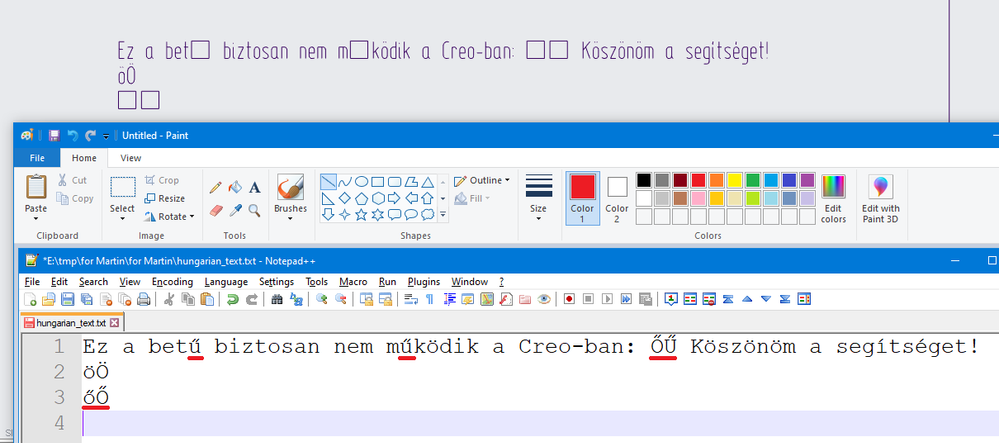

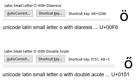

please look at the following picture. Letters underlined in red are displayed as squares in Creo. This should mean that these letters are not included in the font definition.
I changed font to Arial WGL. Below you can see the result.

1.] fnt files are identical
2.] squares in Creo note are side effect of adding following line into parametric.psf
ENV=PRO_LANG=english
I removed this line and tested adding note using hungarian_text.txt

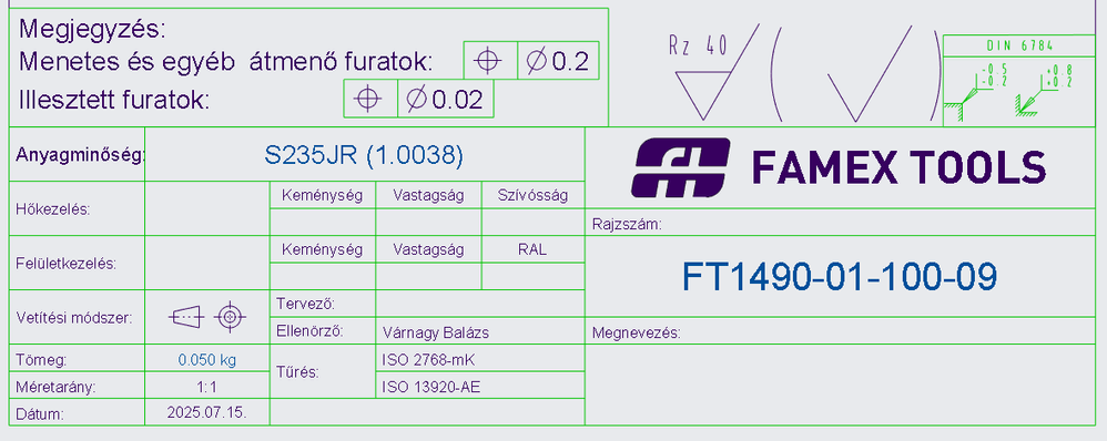

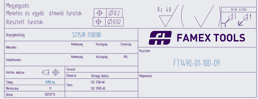

3.] in a4-famex_m.frm file all texts in table are displayed using iso3985font
You have to change font to hu_font to be able to create new drawing
4.] in ft1490-01-100-09.drw file all texts in table are displayed using iso3985font
You have to change font to hu_font to be able to "repair" this drawing.

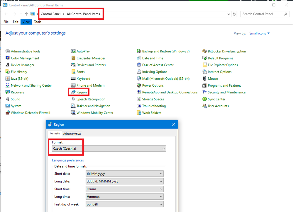

Simple question: What region is set in your Windows? My setting follows.
Martin Hanák
I simply want to undestand how can a format work with one setting and not the other, when seeminly there are no difference between the folder structure.
What I simply see is that IF I set to usascii, it breaks the font, for no reason at all.
your region is set to Hungary, so I expect that you live in Hungary. Why you did not consult your problems with Hungarian Creo reseller?
