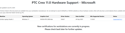

StephenW
(To:Yogesh.T)
I've never seen one used for Creo but Microsoft surface has a certified version
https://support.ptc.com/WCMS/files/176376/en/Microsoft_11.html
