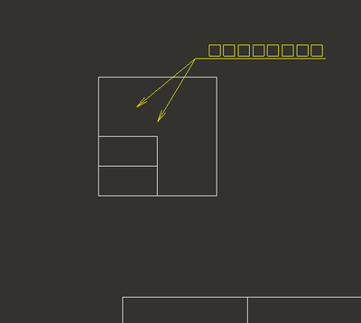

When I create a drawing, the lines that should not be visible behind the thin parts are displayed.
ptc-2170706
3-Newcomer
I am using Creo Parametric Release 4.0 and DatecodeF000
The leader line of drw0001.drw.1 is a line that is not originally displayed.
StephenW
(To:ptc-2170706)
This is an accuracy issue. The parts are extremely thin compared to the overall size. I fixed it by changing accuracy from relative to absolute and also the value to the smallest I could set it, which seemed to be .006 absolute for each part and also the assembly. Accuracy is a funny thing and cause unexpected issues.
I don't remember but I think on creo 4, you  may have to enable absolute accuracy using the option enable_absolute_accuracy  yes
thank you.
Problem solved.
