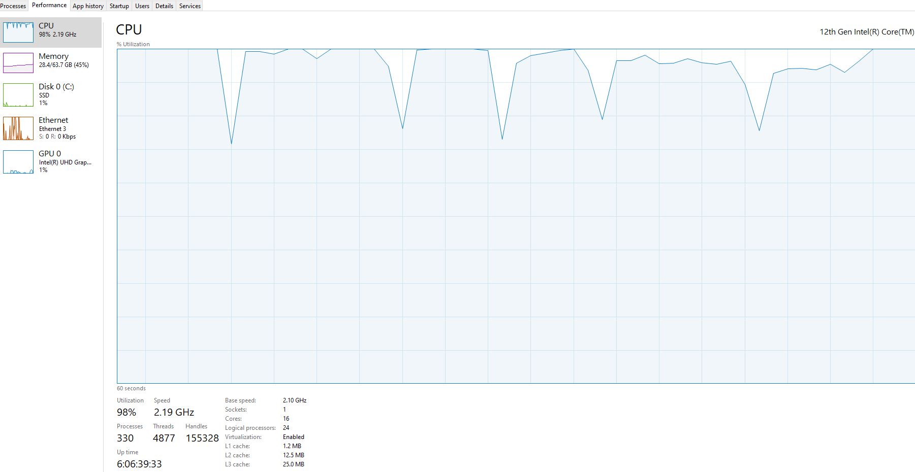

I did some extreme rendering on big assembly and got some data to browse and see what you all think. Pl see images. Random snap of Task Manager performance. What comes up would be interesting to know.
So it looks like the rendering is being done by the CPU and not the GPU.
A desktop CPU is going to be able to significantly out-perform a laptop CPU for less money.
You captured a "Overall utilization", also set the view to "Logical processors" to see whether rendering is using single or multi-core.
Compare CPU performance for single or multi-core depending on above view and spend your money improving that type of performance.
Also, you are using more than 32 GB memory, so make sure you configure with at least 64 GB.
