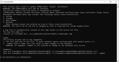

how to add parameters in model automatically? We have alot of old parts on the server. Our machines are always updating so all the old parts are edited/used each year. This year because of technology we need to add new parameter to each part. Is there any way how to add it on checkout or with the help of modelcheck or other way how to add parameters without manual work?
@ilyachaban ,
The tool reads a CSV file in the format;
<EPMDocument idA2A2>,<Global Attribute Internal Name>,<Reusable Attribute Data Type>,<Attribute Target Value>
The tool reads each line.
Finds the EPMDocument
Adds the value to the attribute.
The utility could be modifiy to use EPMDocument number rather than EPMDocument id.  That would not be a problem.
Just spec out how you'd like it to work and I write it that way.
Note: the utility runs includes and -commit argument.  If -commit is not entered no database changes are made.  The run is logged but I like to make sure we are really ready to make changes therefore the I include explicit use of -commit.
I write lots of tools, if you need help feel free to reach out to me.
BTW, this is a hobby for me now.  20 years doing this stuff but retried now and just can't stop doing the fun stuff.
The help loos like this:

@ilyachaban ,

Currently we have two variations:
  • One runs on check-in and automatically synchronizes each drawing's parameters with its parent model's parameters.  (part or assembly)
  • The second is a utility that is run from a Windchill shell,  It will create (if necessary) and set parameter values for any CAD object,  Input is from a text file (.csv).  It does this without checking out or iterating the object, and it can update any version (iteration or revision).
