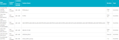

Hi Everyone, I have student license(Creo Lab Pack) can I borrow this license like Floating license?, anyone can help me

I already Checked on E - Support and the type is FLoating not locked, any suggestion? Can I borrow this license
Leo
you picture tells me that your university ordered license package containing qty 480 of ProE_Educ1 Creo license -AND- these licenses are not installed.
step 1.
You have to specify which computer will serve as the license server.
step 2.
You have to get physical address (MAC address) of Ethernet network card installed in license server.
step 3.
You have to install Creo licenses on this MAC address. You will get license file.
step 4.
You have to install FLEXnet license manager with the use of the above mentioned license file. License file containing BORROW keyword must be used!
step 5.
You have to modify server.xml file (located in C:\Program Files\PTC\FLEXnet Admin License Server directory), to enable license borrowing.
adminOnly="false"
licenseReclaimAllowed="true"
step 6.
You have to restart lmadmin_ptc service.
On PC where Creo is installed you have to run parametric_borrow.bat -OR- ptcborrow.bat. These files are located in Parametric\bin subdirectory.
