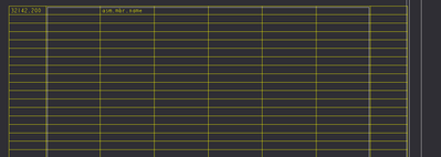

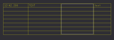

Here is what I put into the template form:
And here is what shows up when I apply it to an assembly drawing,

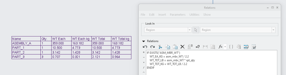

StephenW
(To:RL_10410177)
Notice on TomU's, anything defined in the repeat region relations don't use asm.mbr.xxx, they use &rpt.rel.wt_kg
TomU
(To:StephenW)
Yep, what @StephenW said.  From your picture above, you would need "&rpt.rel.WT_KG" entered in the table cell.
Just to test it, hard assign a value outside the IF statement in the relations.
WT_KG = 12345

on the template:
symbol on the drawing:
still blank. didn't pull the hard value either:
Thoughts? I really appreciate yal'll helping me with this.

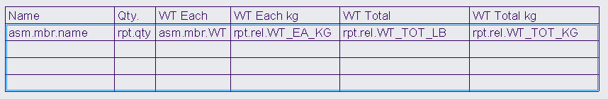

It sort of looks like only that one cell is your repeat region.  It's going to be much easier to troubleshoot if you have some additional columns in the repeat region for debugging.  Add "&asm.mbr.name" to one column and &asm.mbr.WT" to another, just to see what kind of inputs you're getting to the relations.

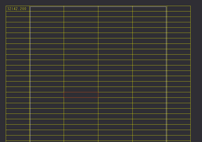

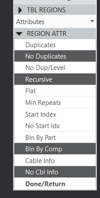

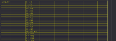

RL_10410177
3-Newcomer
(To:TomU)
table with more columns:
that created a whole bunch of rows this time, not sure why.
here's the region attributes for reference:
TomU
(To:RL_10410177)
Please use &asm.mbr.name in one of the columns, just for now...

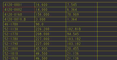

RL_10410177
3-Newcomer
(To:TomU)

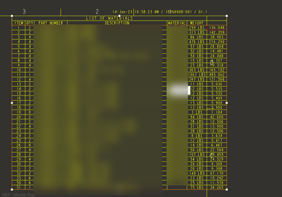

StephenW
(To:RL_10410177)
does every part have a parameter in the part called wt? I think that is problem one
You can use the system weight parameter PRO_MP_MASS instead.
StephenW
(To:RL_10410177)
You may want to download TomU's zip file on his original response.
There are several things I see in your table. I assume you are working in a drawing with an assembly as the model and that model is the active when you are creating this table.
The first cell, you are calling the weight as just a parameter cell, not in the repeat region. To use the relations, I think you need the weight used in the table.
Add in the name using asm.mbr.name first with no relations to make sure you get a table generated, then add  in the weight so that shows (still no relations)
Then add in the relation and the callout for the relation. I think you are fighting multiple problems and haven't ever gotten a basic table started.
I kinda got it to work with rpt.rel.wt_kgs using this relation:
I say kinda since there are some blanks for some reason.
So this is great for a BOM table, but I just want it looking at the top level. Would I need an if statement to single it out?

TomU
(To:TomU)
Working example in Creo 4.0 is attached.
