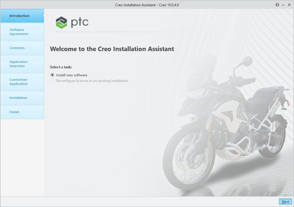

Hello, I'm trying to upgrade to Creo 10. I received my license text files through email. I went to the software download page and got the latest version of Creo 10 (Version: 10-0-4-0) and downloaded the .zip file.
The problem I'm having is that the setup.exe file does not seem to work. When I double click or right click>run as administrator nothing ever happens and no installation window ever opens. However, when I go into Windows Task Manager I see a process called "PTC Installation Assistant" which is running. If I don't end that process I get an error when trying to re-run the setup.exe file which states "Please exit the already running installer or uninstaller first."

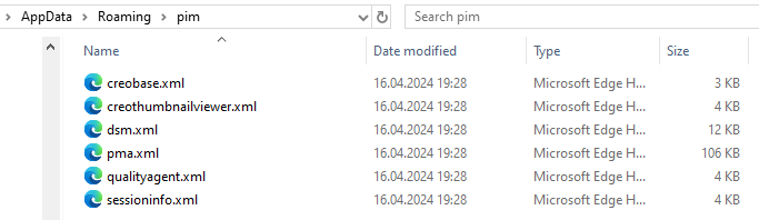

when I launch setup.exe, installer creates pim subdirectory in %APPDATA% directory and displays following window
%APPDATA%\pim directory contents
Yes, that pim folder is populated with those same .xml files on my machine as well. I deleted the pim folder to make sure and when I run setup.exe that pim folder gets created with all the same .xml files. I just don't ever see the Installation Assistant window pop up anywhere. It's a complete phantom it does not show up in task bar or minimized anywhere.
