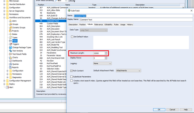

This sounds like you may be reaching the character limit of the particular text field having data be imported. Check the configuration of the text field in the administration client like below:
1 REPLY 1
