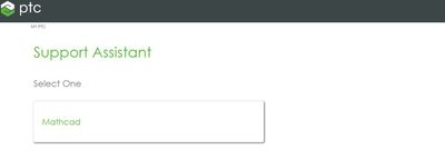

AlexG
(To:Catalina)
Hi Catalina.
Thanks for your feedback. I tried to open a support case. Unfortunately my account only shows me the option to open a case for Mathcad. I was not able to find out how I can create a case for RV&S 13.2.
Can you help me with this?
Thank you!
