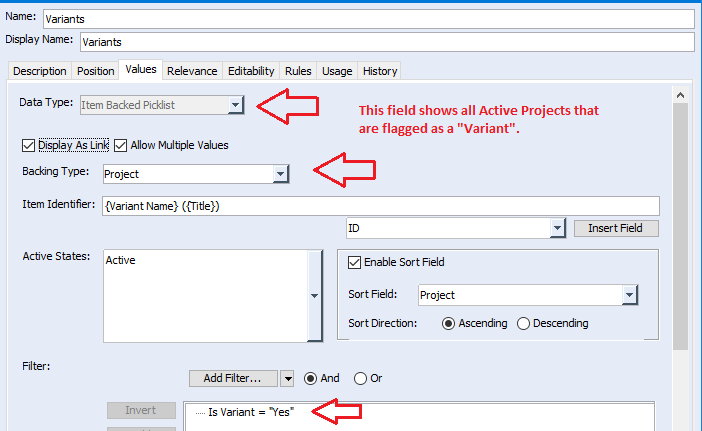

On the Issue type, we use an IBPL called "Variants" that allows to pick any Project items flagged as a variant:

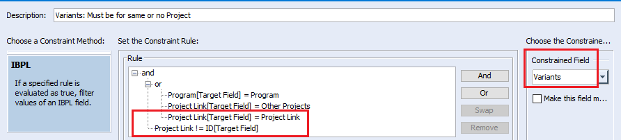

But we want to select only the variants that are relevant for the selected project, so we add a constraint on the Issue type. Note that the picklist we use for projects is not the "Project" field, but another one called "Project Link".  The constraint is:

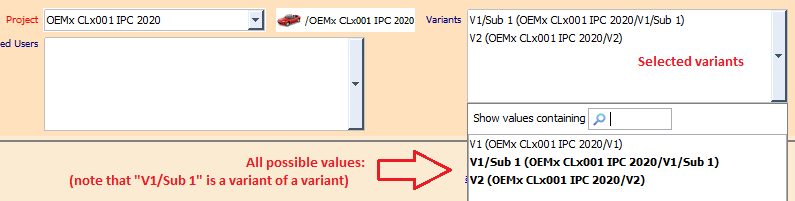

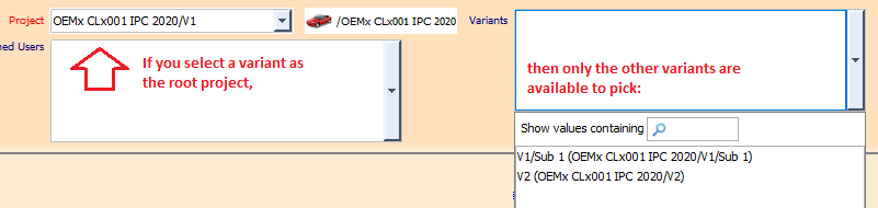

Without going through all the details, the constraint essentially says "only select the variants that belong to the same Program but exclude the current project". For example, if our issue selects Project Link "ABC", then the two variants are shown. But if the Project Link is "ABC/Var1", then only the second variant is shown.
Examples:

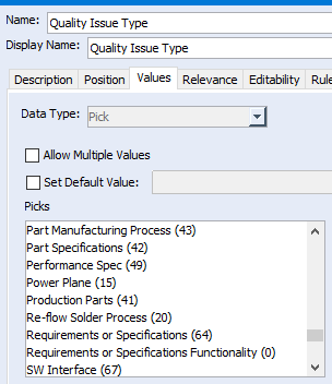

2) Simple pick list with constraint
Our issues can be categorized, for example, if it's a Quality Issue, all possible values are defined here:

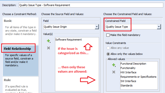

But on the Issue type, values are constrained based on some other field value used for further categorization:
I believe this answers the question "define drop-down values for a field dynamically?".
Note that no scripting (e.g. trigger) or "html code" are required.
