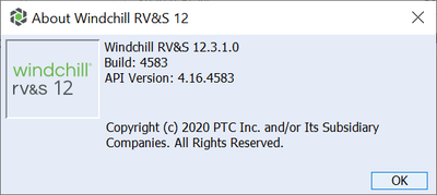

Here is the version we use:
Windows 10 Enterprise. 64bits OS, x63 based processor
