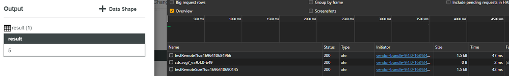

We fetched 5000 rows and 4 columns from sql db in 40seconds.
Then In Thingworx code, if i used InfoTable.length to find total number of rows in table is taking additional 20seconds.
Any other shortcut to get table length quickly.?

Hi @AP_10343008
You can try
infoTable.rows.size()
 but I'm not sure whether it will improve performance. Please do a comparison between the size and length
For 5 Rows of Data, Size() runs faster than the length method

I find it strange that infoTable.length would take additional 20 seconds, if run just once.
Can you share all the service code where you observed this situation?
    let queryA = "sql query........";
    result = Things['SmartParts.DataBaseConnector-TH'].Query({
        inQuery: queryA
  //if temp infotable used to calculate length, then it is taking some more time to give results. SO using same result infotable
    let count =result.rows.size();
    if(count>0) result[0].COUNT=count;
    else result[0].COUNT=0;
