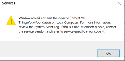

Apache Tomcat 9.0 ThingWorx-Foundation fail to start showing following error.

I took a look at the error messages in the log file you provided.
It looks like you have Java 11 installed and are trying to use ThingWorx 9.0.x

Hi @MV_9521008.
From the log, there appears to be an issue with java. Which version of ThingWorx are you installing? Did you check the System Requirements to ensure you are installing a compatible java version? I'll be happy to send you a link once you advise the ThingWorx version you're running. Please advise too which O/S you are installing on.

I confirmed the Windows, Java and Thingworx. All seems OK to me.
Windows - Enterprise 10
Java - Java SE Development Kit 8, Update 241 (64-bit) (1.8.0_241)
ThingWorx Foundation 9
