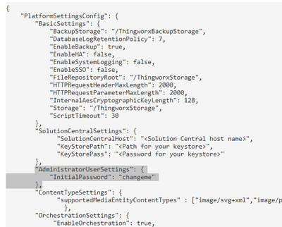

I can start Apache Tomcat and it running a while then stop, I checked the error log and found :Admin Password entered did not pass validation. Check inital admin password set in platform-settings.json.
I also checked my platform-settings.json configuration, it is ok, I attached it as below:

platform-settings.json:
You need to add the Administrator user password field on the platform-settings.json file
hope it helps you
4 REPLIES 4
hope it helps you
Hi
Thanks a lot, it works. Although I am still confused that why the same json file was used in other server is ok, I have to add this field in it. Anyway, thanks, I will confirm it with my colleagues
I assume they followed the instructions https://support.ptc.com/help/thingworx/platform/r9/en/index.html#page/ThingWorx/Help/Installation/Installation/install_java_and_apache_tomcat.html
4. Configure the Administrator password.
9. Start Tomcat
14. Change initial Administrator password -> c) Delete the initial Administrator password from platform-settings.json
Yes, you are correct, they delete the field after change password...
