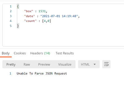

Hello there,
I am trying to send a JSON as input parameter of a service that I created, from Postman, but I get the following error message :
"Unable To Parse JSON Request"
Here is the structure of my json :
    "box" : 1531,
    "date" : "2021-07-01 14:19:48",
    "count" : [4,0]

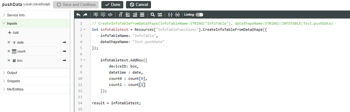

So I selected the follow inputs for my service :
box -> number
date -> string
count -> ??? (I don't know what I have to put, I tried 2D, infotable, json, but nothing works...The parameter count is an array...)

Hi
Looks like you didn't format the body correctly in Postman and you need to change the Input Parameters to json type in ThingWorx service.

Hi, I copy and paste the json into a service's input parameter and it seems working just fine.
How did you send Json from Postman to the input parameter of a ThingWorx service?

Here there is my postman Body : (you will notice that I don't have variable, only parameters)
Here there is my ThingWorx service :
By this way it's not working...
I tried also to put a json as in input parameter but I don't have the name of the JSON variable (if you look at my postman POST), so I don't know how can I select my input parameter...

Hello Tony,
Sorry for the delay, I didn't get any notification, but everything is working.
Thank you!
