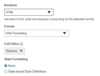

there are several ways to display HTML elements.
If the data ends up in a grid, you can set the Column Renderer to "HTML" and Format to "with Formatting".
An alternative is the value display. (Help Center)
Here you can also set Renderer "HTML" and Format "with Formatting".
